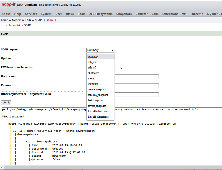

Thomas just published a small interactive Perl script for easy ESXi web management via SOAP. It even works with ESXi free, see ESX / ESXi - Hilfethread

Howto:
Update napp-it to newest 23.dev where the script is included
example: list all datastores
perl /var/web-gui/data/napp-it/zfsos/_lib/scripts/soap/VMWare_SOAP.pl list_all_datastores --host 192.168.2.48 --user root --password 1234
Attached Datastores "63757dea-d2c65df0-3249-0025905dea0a"
Attached Datastores "192.168.2.203:/nvme/nfs"
example: list VMs:
perl /var/web-gui/data/napp-it/zfsos/_lib/scripts/soap/VMWare_SOAP.pl list_attached_vms --host 192.168.2.48 --user root --password 1234--mountpoint /nvme/nfs --mounthost 192.168.2.203
Attached VM ID "10" = "solaris11.4cbe"
Attached VM ID "11" = "w2019.125"
Attached VM ID "12" = "oi10.2022"
Attached VM ID "14" = "w11"
Attached VM ID "15" = "ventura"
Attached VM ID "16" = "danube"
Attached VM ID "9" = "omnios.dev.117"
example: create snap
perl /var/web-gui/data/napp-it/zfsos/_lib/scripts/soap/VMWare_SOAP.pl create_snapshot --host 192.168.2.48 --user root --password 1234--mountpoint /nvme/nfs --mounthost 192.168.2.203 --vm_id 9 --snapname latest --mem --no-quiesce --snapdesc latest
example: list (latest) snap
perl /var/web-gui/data/napp-it/zfsos/_lib/scripts/soap/VMWare_SOAP.pl list_snapshot --host 192.168.2.48 --user root --password 1234 --vm_id 9
I will use the script to work together with a normal autosnap job in a future napp-it. Up to then you can create a jobid.pre (ex 123456.pre) in /var/web-gui/_log/jobs/ with a script to create the ESXi snap and a jobid.post to destroy the ESXi snap after it was included in the ZFS snap.
update
Ich habe ein SOAP Menü ins neueste napp-it 23.dev eingebaut

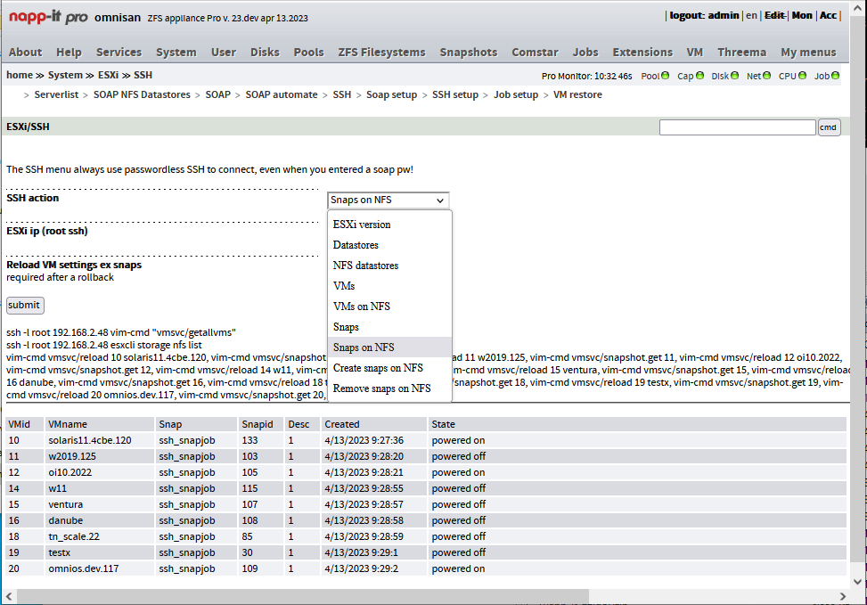

Neues Feature in napp-it 23.dev (Apr 05):
ZFS autosnaps und ZFS replication bei ESXi/NFS Dateisystemen mit ESXi hot memory snaps.

Update:
Ich habe den bisherigen SSH Mechanismus um ESXi snaps (mit memstate oder quiesce) in ZFS Snaps zu integrieren so umgestellt dass er gleich funktioniert wie der soap Mechanismus. Man muss für SSH halt Keys erzeugen und den Public Key auf ESXi eintragen. Man hat damit aber remote Zugriff auf alle esxcli und vim-cmd Konsole Befehle.
