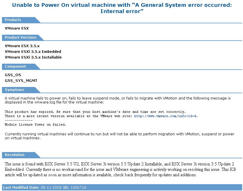

Beitragvon Raudi » 12.08.2008, 14:42
Hier mal ein Screenshot vom KB Eintrag.

We are currently testing an option to apply the patch without requiring VMotion or VM power-off and re-power-on at the point of patch application.
