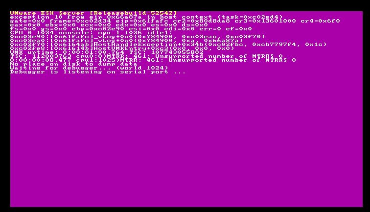

Beitragvon bandit600 » 07.02.2008, 17:18
super.. hilft mir ganz gut.... setup läuft auch ganz gut, hab mir ne esx 3.0.2 von vmware geholt...
hab beim booten des installiert vmware nur folgende fehlermeldung....
hilfe!?
Beiträge: 13
Registriert: 07.02.2008, 09:59
Beitragvon bandit600 » 07.02.2008, 17:36
ahbe jetzt folgende config in der vmx:
# sets hardware version and guestOS
config.version = "8"
virtualHW.version = "4"
guestOS = "otherlinux"
# note - setting the target-platform to "esx" forces you to use scsi for the esx-system -
# I would not recommend that - system on IDE seems to work nicer ?
deploymentPlatform = "windows"
displayName = "ESX-Testwiese"
# essentials - this allows to run a VM in a VM and adds VT support
# by the way - this also allows to run VMserver in a VM
monitor_control.restrict_backdoor = "true"
monitor_control.vt32 = "true"
# one e1000 nic - bridged
ethernet0.present = "TRUE"
ethernet0.virtualdev = "vlance"
# a second e1000 - bridged
ethernet1.present = "FALSE"
ethernet1.virtualdev = "e1000"
# floppy - configured but not used
floppy0.autodetect = "TRUE"
floppy0.clientDevice = "FALSE"
floppy0.fileName = "boot.flp"
floppy0.fileType = "file"
# ide-disk for the esx-system
ide0:0.fileName = "Other Linux.vmdk"
ide0:0.present = "TRUE"
ide0:0.redo = ""
# ide-cdrom - used for installation
ide1:0.autodetect = "TRUE"
ide1:0.deviceType = "cdrom-image"
ide1:0.fileName = "esx-3.0.2-52542.iso"
ide1:0.present = "TRUE"
ide1:0.startConnected = "true"
# ram and cpu - you really do NOT need 2 CPUs
memsize = "2008"
numvcpus = "1"
# a scsi-disk for local vmfs-storage - must be "lsilogic"
scsi0.pciSlotNumber = "16"
scsi0.present = "TRUE"
scsi0.virtualDev = "buslogic"
scsi0:0.fileName = "vmfs.vmdk"
scsi0:0.present = "TRUE"
scsi0:0.redo = ""
# misc
pciBridge0.present = "TRUE"
sound.autodetect = "TRUE"
sound.fileName = "-1"
sound.present = "FALSE"
svga.autodetect = "TRUE"
isolation.tools.hgfs.disable = "FALSE"
floppy0.present = "FALSE"
Ethernet0.addressType = "generated"
Ethernet0.generatedAddress = "00:0c:29:53:3a:c8"
uuid.location = "56 4d ed 2e f2 b8 b3 c7-f5 96 de 14 9c 53 3a c8"
uuid.bios = "56 4d ed 2e f2 b8 b3 c7-f5 96 de 14 9c 53 3a c8"
priority.grabbed = "normal"
priority.ungrabbed = "normal"
